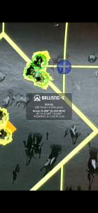

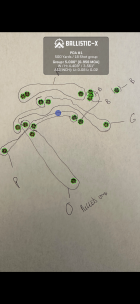

I have a 223, has about 600rds down the barrel now. When I did my load development I picked a charge weight then .010 jam then used my tuner. This was around 35-45deg. My tuner setting was giving me .2-.3 at 100yd 5shot groups and I shot a 1.8in group at 500. At this time the rifle had just over 100 rounds on it.
I shot today and the temperature was 97° last month it was about 80. Shooting at 100 it is now grouping around .5 to .75. Velocity is still consistent with the load development I did in cooler temperatures.
I can tell when shooting at a distance the grouping has opened up more, is it possible that I need to adjust my tuner based on temperature change and environmental factors or is it more likely that I am experiencing some throat erosion and need to load my rounds a little bit longer?

What do the new groups look like? Mostly straight vertical would be my guess, at least with my tuner and of course you have to account for wind, always
Pics? Was it actually out of tune? I mean, small, one hole groups is what we're looking for but yes, even those should have a repeatable shape.
Unfortunately at the zero range there’s too many people shooting to go down range to take a picture of your target, but the best way to describe the new group is a round hole but more open, versus stacking all the rounds in a very small hole

So I’m pretty sure I am in a good combustion area. The velocity has been consistent as long as my loading technique is consistent all the way from temperatures of 30° to 90°. When I did my tuner test across 20 shots the group was 5 inches overall while changing tuner settings which I was pretty happy with
It shot groups like I posted pictures of consistently until the temperature reached the 80s and the 90s almost 100° the other day.
