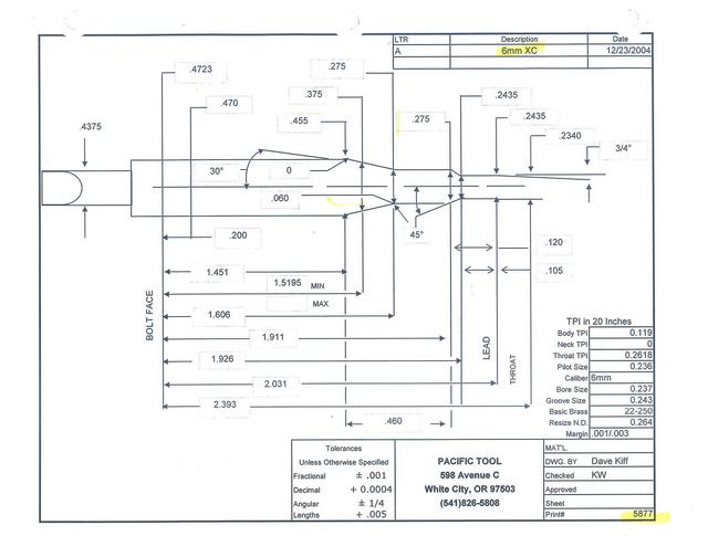

Just to bump and old thread and continue voicing into the echo chamber since the freebore was being discussed with regard to lighter bullets. I have the standard ptg reamer with .105 freebore as shown in the above chamber print via damon.

The .105" freebore is great with the 105 and 115 gr bullets, it starts to get a bit long for the lighter stuff. I agree that a .055 freebore would be pretty perfect for a rig that isnt going to be used with the uber high bc bulets.

But as far as 6xc goes (with other bullets as well) I think the .055 number that was floated above would be just hunky dory with barely any downside. You could still do the 105 gr bullets without robbing too much case capacity should you want to try for a bit longer distance without letting these lighter bullets float right at the end of the case neck like it is with the longer freebores. It would be nice to have the option without it being a special order reamer or anything.
