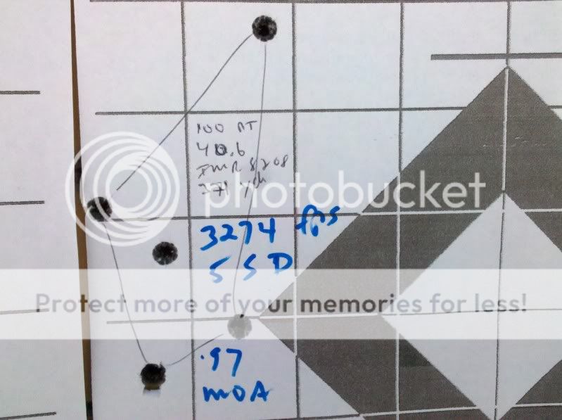

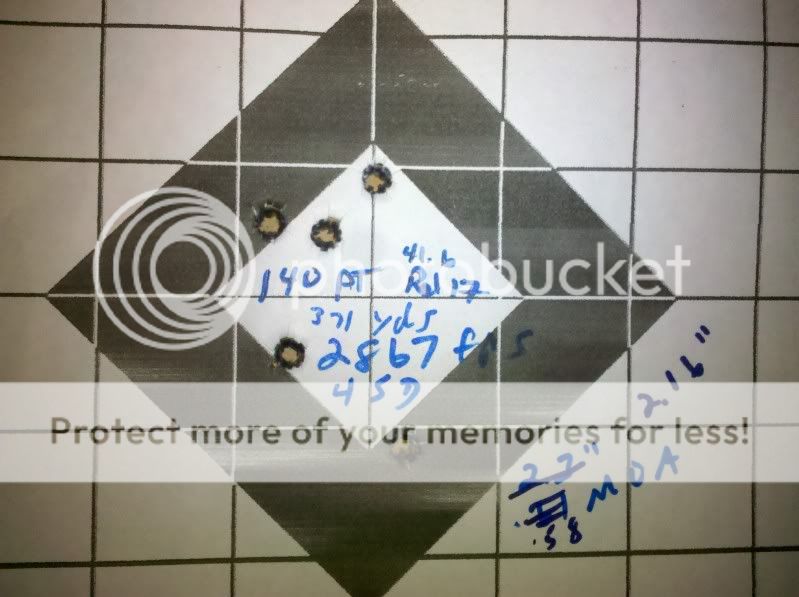

I have just built a 7-08AI hart bbl 24" #3 taper fluted on a 700SA, with Luepold 4.5-14x weight 7.2# in HiTech stock - expect 140 gr at 3000+
going to fire form and crono this weekend subject to weather.
