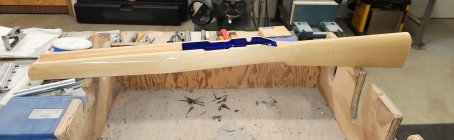

Kelbly's now has a stock on the Kelbly KLP design made of Basswood three layer by X-Ring stocks for LV. Retails for 825.00 in flat top and 1750.00 completed with trigger guard and butt plate with high gloss finish. The stock weighs 32 ounces with butt plate, trigger guard and mounting hardware. The old carbon fiber, fiberglass KLP we made weighed 30.86 ounces with trigger guard, butt plate, hardware with pillars installed. You can easily make LV weight with Panda action.KLP X-Ring 7.jpg
