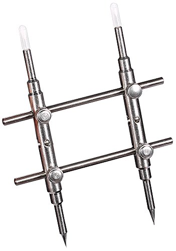

Gary, Take a look in the end of your scope. Down inside the objective bell is a steel or aluminum locking ring with two notches. That's what needs to be removed.
Just what the heck is a strap wrench going to do?
Lens spanner wrench...one end is pointed one is flat.
