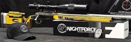

Here are a couple of mine!

Hey KT! I must admit, I never used to like "wild coloring" on ANYTHING... But in the last couple of years, I have changed my tune. Your "Wild Blue" rifle looks AWESOME! I will admit, I am a bit envious of something that nice looking! Great job!!
Thanks Ben
I can't really take credit though. I supplied the parts to Accurate Ordnance and told them to do what ever they wanted. I will admit it's pretty weird to see 3 extra blue barrels sitting in the safe. LOL
KT
KT, I believe they actually give you a slight edge. How so? Well, it is human nature to be intimidated by something we perceive to be better than what we have, whether it is or not! That little psychological "edge" could give you exactly what you need to win during a very close match. That rifle's looks will be etched in the competitors mind while he is shooting! That MAY cause him to second guess his hold or whatever>>>So what! Just as long as it gives you an edge!
