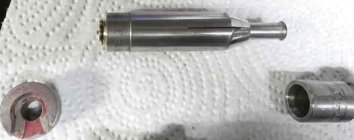

Here is my SA284 Winchester collet die that I modified from
the Lee 7/08 die.
