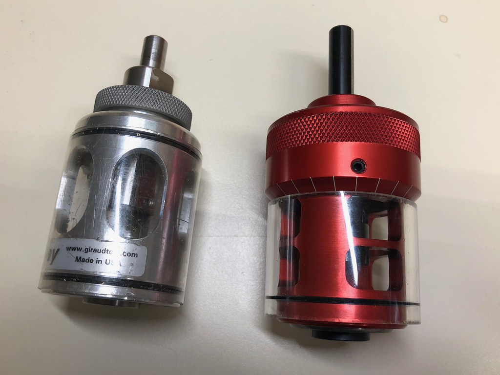

I have owned the WFT and the Giraud Tri-Way, sold them both.
I think the Trim-It is the best execution of that type of power trimmer. Check them out, they are even having a sale right now.
https://www.blackwidowshooters.com/
I realize these are not what the OP is asking about so I'll apologize up front but in my humble opinion they are worth a further look. I have the newest alliteration of the Trim-it II and the Giraud Tri-way. Both do the same thing in the same way. The cutters appear to be the same. Both perform well for me. Very accurate and repeatable. Perhaps I'm just lazy but both of these trim, de-burr and chamfer in a single operation. I just got the Trim-it a couple of weeks ago and am quite impressed with it. The micro-adjustment feature is very nice and much simpler to get the trim to length set vs the Giraud. The newer Trim-it II has a lexan shield to prevent the chips from flying all over similar to the Giraud which is a nice addition. The Trim-It II also has interchangeable caliber inserts for $20 each where the Giraud is caliber specific.
