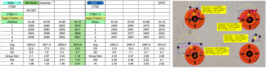

I'm loading .308 for two of my sons for their Sig 716s. One uses Peterson, the other is using Starline. The Starline is loaded for 150 Hornady SST and the Peterson is loaded for 168 SMK. So far for the 150 SST we've tried Varget, N140, N150, N540 and it like N540 the best, so far. Not too deep into it yet, but dialing it in.

I am going to disagree with this a little. LC. FC and Lapua are all very similar in case capacity and published loads based on those cases don't very that much. HOWEVER, loads based on some of the lighter cases such as Winchester, Hornady, and some Black Hills will vary significantly and the 2gn suggestion does come into play. Screenshot 2025-10-17 at 11.04.52 PM.pngScreenshot 2025-10-17 at 11.04.13 PM.png
