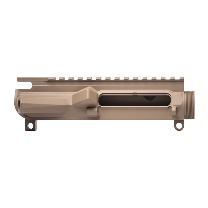

I have an AR in .223 that hasn't seen the light of day in years. It is an A2 set up for service-rifle comp, but I have not been able to see through peep sights in a very long time. I started shooting F-Class and now benchrest so this rifle is just collecting dust. It is time to fix that issue........ I plan to repurpose it into a varmint rifle.
John at White Oak Armament built the upper, so I was planning on using all those parts on a flattop and fitting it with a scope.
Besides M4 feed ramps, is there anything in a flattop upper I should be looking for? Recommendations?
BTW, this is a 7 twist that will spend the rest of its days pointed at chucks and yotes.

Try to find a thermo fit upper receiver. BCM is one. That way you do not need to shim or bed the barrel to receiver
