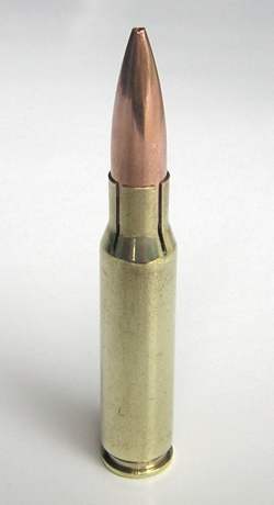

When you use calipers to measure OAL, you get a specific measurement of the overall length of the cartridge. However, that doesn't take into consideration the variation of bullet tips, and it is almost meaningless without ALSO knowing the size of your particular chamber. In fact, if you're concerned about accurate seating, all you really need to know is the distance between your bullet and the rifling. Using a slotted case (like the one below) is explained on the webpage link I emailed you. http://www.larrywillis.com/OAL.html
Measuring to the bullet ogive is far more accurate (and more consistent) than measuring to a bullet point. Just chamber a slotted case (like this) and let your rifle seat the bullet. Then compare this to your handloads, and you'll see "exactly" how deep you to seat your bullets - right at the rifling.
