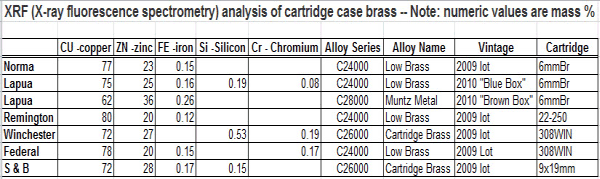

X-Ray Spectography results from this Daily Bulletin article - Click Here
Fred's results were independently done, that came after the fact, to what many suspected back then. It was obvious to me that something besides the box and neck thickness had changed. Fred's results confirmed it.
