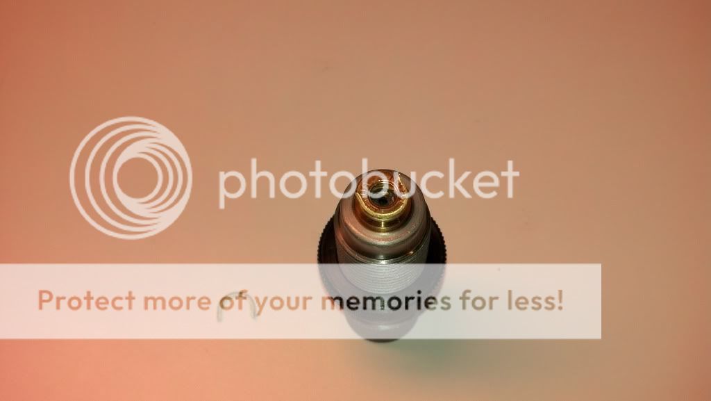

I know you are trying to help and I don't mean to be a jerk but I'll probably come off as one, so be it.
After reading that I thought, "hmm having a problem by inserting the case a little way into the die, fix said problem by shoving the case all the way into the die"
Sounded like something I would have tried in my preschool days, if doesn't fit then wail on it...
So of course I had to give it a try to just see how bad the results would be, I present them to you now;
looks like you need a stuck case remover if you have a lath you can make one from a 1/4 or 3/8 bolt. just turn the head of a 1-1/4" long bolt to the same size as the bottom of a shell holder. drill and tap the brass to size of bolt and insert bolt in the case screw die into press and slide the shell holder in place with the ram up and pull hard. the first time I did that i tried to drive the case out of the die with the decap rod... not good LOL. if you don't have a lathe they sell kits like rcbs
good luck!
ps I think you need more lube.
