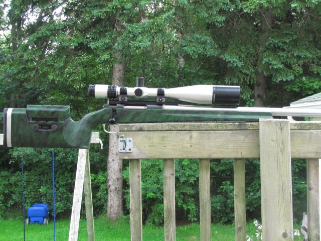

Built a 34 inch 10 twist long throated .308 F-class gun to launch the Lapua 220's
Have easy access to Vihtavouri powder.
Any suggestions on starting loads?

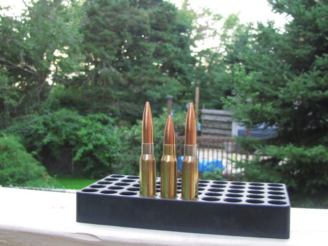

N-150 in Lapua Palma brass would be the first combo i'd try if i were testing that bullet with Vihtavuori powder.....It's a single base clean burning and accurate powder. I'm hesitant to suggest a starting load as i've never shot that particular bullet nor know anyone shooting it in FTR.
N150 was going to be my first choice, somewhere in the 40g range. Lapua Palma brass is always the way to go with "max" loads.
Looking for 2300-2400 fps to start.
Sierra lists nearly 42g with their 200s. Going to try to compare bearing surface length.
Norma 168 factory load middle for comparison.
