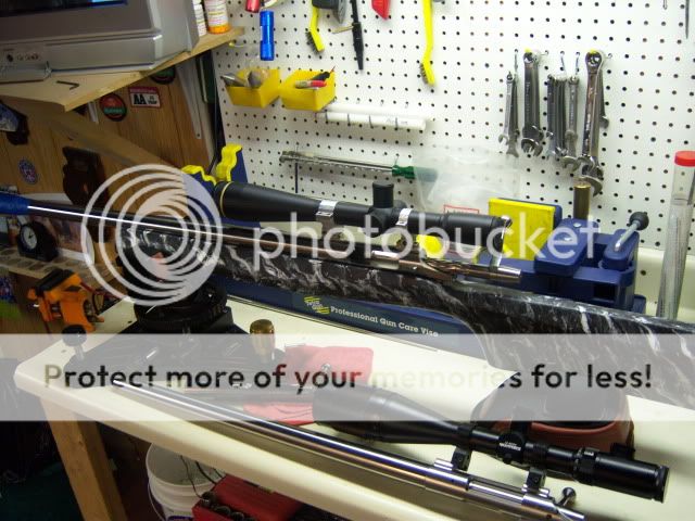

thats very nice!! I ended up going with the mcmillan st-1000 as the obeche stock that was sent to me had some issues. I think the mcmillan version will be very nice as well. I plan on sanding it down and having a clear coat applied. the colors are black and white swirl. It should look very nice!! I will post a pic here in a minute. Lee
