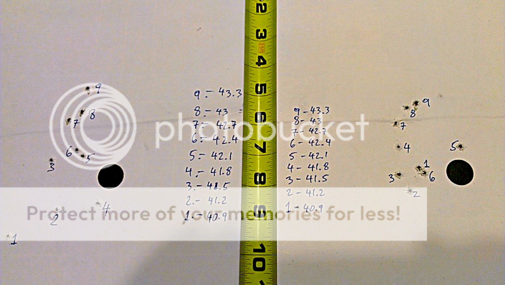

When I run a Audette Ladder test, I do 2 or 3 of the same on different targets so I can correlate them. This way I can be 100% sure of the charge weights that are stable from shot to shot.
Example of a ladder test I did at 328 yards (300meters)....
By correlating both results, I know for a fact that 7-8-9 land in the same spot every shot. So I settled on # 8 (43gr) and when I went to verify the 43gr load with a 5 shot groups at the same distance of 328 yards, here is a pic of the results....
This is a 243w shooting 107smk, H-4831, Win. Brass, 210m.
Example of a ladder test I did at 328 yards (300meters).... I would have been tempted to try 43.1, 43.2, and 43.3 at a 3x6 to see what it would have done..
I like that, thanks for that tip!
How do you know which hole is which shot when you're done?
i am writing it down as i go.. so i had a pc of paper with the image of the target and i would dot it and draw a line to it with a number.. were i screwed up on that one target was transferring the info to the target.. so spank me..
