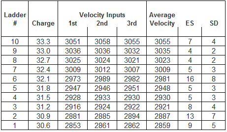

Below I am adding in 3 separate ladder tests conducted at 450 yards of 10-increments each. Resultants compiled as data, to show from a data standpoint what can be learned from ladder testing.

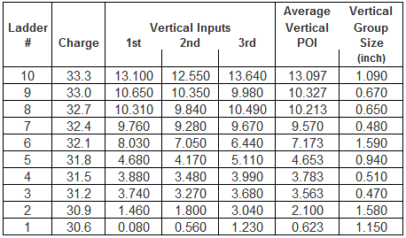

Here is the complete Velocity data and Vertical dispersion data of the 3 separate ladders:

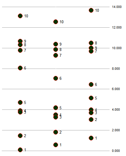

Here is the measured POI Vertical dispersion plotted from the 450-yard target:
As I stated above, vertical dispersion is my primary concern and the ES between charge increments. I plot and measure the vertical dispersion of each bullet hole from a common point on the targets and add that data to my discovery sheets/records.
Each ladder was ran individually, then repeated after ample time to let the barrel cool between each ladder.
The 1st ladder alone yielded conclusive results. The 2nd and 3rd repeated ones clarified the vertical dispersion and velocity confirmation, that in all actuality were not needed.
The rifle used is a 1000BR rifle chambered in 6Dasher with 105-VLD/RL15/CCI-450/Lapua brass.
