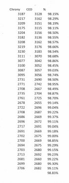

I have both. Most days the numbers are super close, but on some, there are readings up to 30-40 fps difference, consistently.

Dont know about the Caldwell but the Labradar was pretty accurate in this test.
