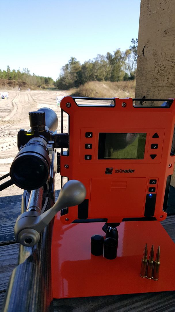

My Labradar arrived the Thursday evening and got it set up and finally made it to the range this morning. So me and a buddy got to test it out a little.
First thought: So simple to set up and was shooting in less than 2 minutes. No calling the line safe and walking down to set up the chronograph. And even with the stand the unit is very lite weight

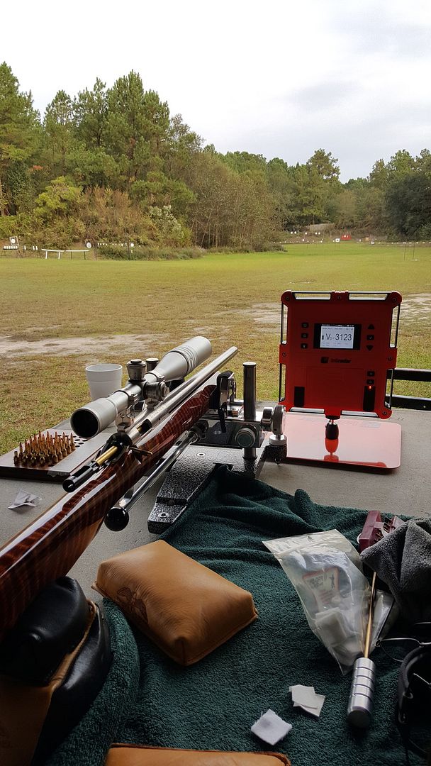

Tested it on his rifle first and he was shooting 68gr bullets in his 6. After the first two shots not registering I went back in the settings and adjusted the sensitivity to setting 1. I also adjust the bullet offset to 12". Vs 6 from the initial setting. He fired a shot and it worked like a charm. Then further into shooting we had 3-4 shots give error message that it could not detect projectile. But then it worked on the others :-\
Then I set up with my rifle shooting 105gr bullets and it picked up all 9 shots and worked great.
**This is just initial thoughts of the unit. Need more bullets down range to test and get use to how this unit works at it's best. But overall it is great. Did exactly what it said it would do. Very easy to set up, displays results quickly, no wires or rails to set up, and no paper to print out to try to understand. The screen is very easy to read and see
Here is Jeff shooting with the Labradar
So Andrew, glad you finally got your LabRadar, I assumed that both rifles were 6 mm with the only difference being the bullet weight i.e. 68gr. Vs. 105gr. Any idea what cause the errors?
No idea. Strange. It picked up about 12 straight then missed 3 shots. Then picked up the rest. It gave an error message
And also with the unit sitting about 6" away from side of barrel it failed to register. Actually shut the unit off and it restarted itself. It did this three shots, sor moved it about 12" off.
Thanks! It’s interesting that moving the unit 12” (I presume 12” off to the side) made it worked better than 6” off. Was that a suggestion as per the documentation?
The setting states 6" will provide more precise readings. Says to place within 18". I may call Tom and see how good their cussing service is. Says to have unit behind muzzle. Which I did.
Maybe I could move further back from muzzle (closer to shooter) but leave it 1-6" offset of barrel. Just little bit more to avoid muzzle blast
We had it just behind muzzle and just off to side at first. Then moved further offset and adjusted setting to the 12" projectIle offset vs. 6" that we initially had.
Try moving it back like to the side of the rest, with larger braked rifles we moved it back just of our elbow and got 100% readings but to much concussion will cause a missed read at least on the early units.

I received mine today and will familiarize myself with the controls, etc. tomorrow. Hopefully, I will be able to test it Wednesday and again on Saturday, using my 6BRX with 105 gr Scenars.

Be sure to have unit behind muzzle about 6" or more. Be sure to aim it at target. Be sure sensitivity is on level 1. Be sure to enter proper bullet weight. Try unit 6" offset from barrel too. And TX setting to standard

We'll got to test unit again today. 308 win using 200gr bullets. Every shot recorded. This was my set up today. Unit was close to barrel. But we'll behind muzzle.
This thing is awesome so far
