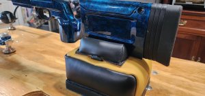

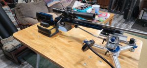

Going through trials and tribulations to get my rifle set up for a bench. A protector rear bag has been meantioned a few times and was wondering what bag or ear spacing would work well with the bravo stock. A 13b with the tracker ear spacing is what I’m thinking. Anybody care to say what works for them ? Thanks

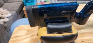

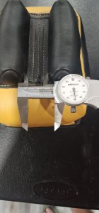

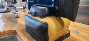

My stock bottom measures 1” then gradually get wider going up towards the cheek piece. I have a .700 ear space bag and it sits on the ears high enough I can put my index finger between the stock and the stitching
You want the stock to ride the stitches ..right now you have a ton of movement up and down
on the back of your rifle. Your going to have vertical issues like mad at long distance.
You need 1 inch between the ears.

SEB Bigfoot. I ordered one of mine to fit the Bravo. The ear spacing is 3/4 of an inch. Measure the base of your butt stock to make sure it has not changed and order accordingly.
