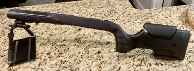

I modified my Exactus a bit. Custom fitted a smooth aluminum bag riding rail cover over the rear picatinny then drilled and tapped the rail for a center mount sling stud. The wood was the dark pepper laminate wood but kinda wished I’d have went with the walnut. Finally decided I didn’t like the pepper color much so I stained it all black. Still need to bed it to the receiver. Planning on doing that this week.
4A595AF2-9206-4EF7-B629-99B76DEB6AF3.jpegE38EAA1F-DDE8-41DA-A79C-FFCF197D6EBA.jpeg4714D136-3290-457E-A7ED-705622A01A09.jpegD8E48620-4ABA-49E3-9D07-F6D4992D0E4A.jpegDACA92D8-4446-45E5-8B8C-94ADF86BFCB6.jpeg
