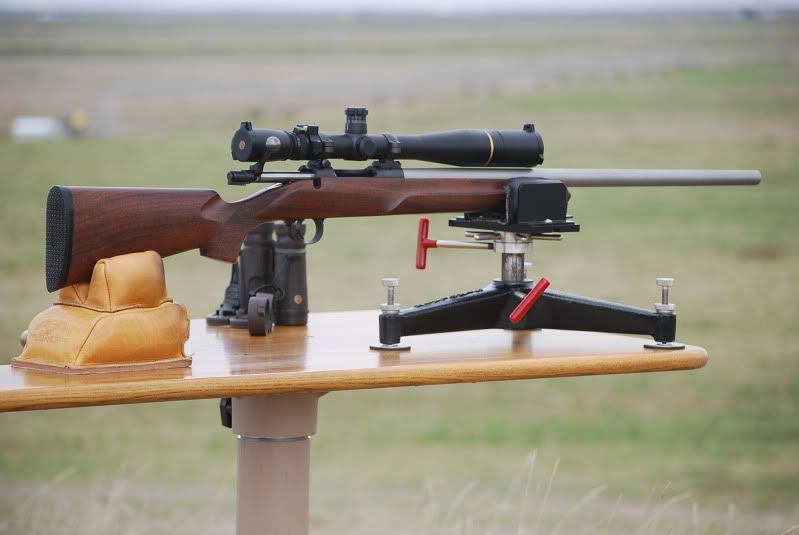

My Cooper 20VT doing what it's designed to do:
The round looks like a mini-308, and we all know how inheriently accurate that number is:
We have great choices, and after over 50 years of launching Skippy and his pals, I've come to the conclusion that the 20VT is the perfect combination of accuracy, speed, no recoil, lack of barrel heat, and just plain fun! :) And from what I can tell lately, I'm not alone.......
