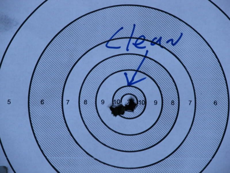

Here's a target I shot with my little boys 82g. 10 shot 100 yrds the x ring is 1/2 moa 10 ring is 1 moa. wind was calm.
