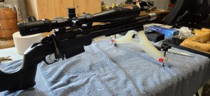

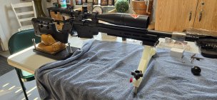

Thanks for the responds. Went out and did a little shooting last night for the first time after changing to the MDT XRS chassis and added the MDT 1 pound weight.

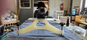

Also put a ARCA rail on and made a custom bipod for bench rest shooting.
The added weight, stiffer chassis and the bipod I built is way better so now that part is taken out of the equation.
I shot with the tuner on and it was not all that great, removed it and that shifted my POA by about 3” @ 75 yards and shot better.
Going to do a good barrel cleaning today and start over again with ammo hunting for the best group.
From your comments, I think by Monday a new barrel will be on the way in hopes it won’t be so picky on ammo and tighten those groups up. Have had a couple of lots of Lapua midas+ and center X that shot really great out of this barrel but it does cost more than most. If the cheaper ammo shoots as well in the new barrel, maybe it will pay for itself, or at least that is what I will tell the wife LOL.
From what you said, I will order the 1.25 in a 24” length. The MDT XRS chassis will accept that large of barrel. I was hoping after changing the chassis and adding the weight… would improve groups enough to where I would not want to spend the cash to get a new barrel, but now I have my mine made up.

I dropped the barreled action into my MDT ACC Premier and fired one 10 round mag through the rifle for a function check.
KI Precision recommends checking headspace with the proper gauge.
Gun fired and functioned like normal.
Scope was installed and I stepped out on my deck to sight in the rifle.
It was getting dark so I didn’t shoot a lot the first night but used a very good shooting lot of SK Biathlon from my steel barreled rifle.
I fired 6 shots to get it zeroed at 50.
The next 10 shots were fired to continue seasoning the barrel.
I then fired 10 5 shot groups.
I didn’t take any pictures but the worst group I fired was the initial 10 round group and it measured .399”
All the 5 shot groups were one small hole.
Below is a picture of a 10 shot 50 yards group. Measuring .322” fired with Tenex. I took this picture after the first day of testing. SK Match and Eley Semi Auto BR produced groups nearly identical to this one with ten shots as well.
