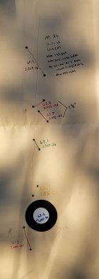

I use 2 with powder (coarse) as a means to identify where to narrow it down with 3 of each. I do everything for a 1,000 yard rifle at 1,000, including bore sighting and zeroing though. I could imagine how the same approach would work at 100, but I would likely change to a level line with multiple aim points.
At 1,000, like below, it is pretty obvious where to continue next session.

Looking at your 1000 yard ladders never gets old :cool:
Lol, that's an oldie! But, that was a good example of a readable 2 shot ladder, that the barrel likes the powder/combo. Most of these things we go straight to finer increments once we've had 100 barrels do the same thing. This wsm was the last time I did a "tall coarse" ladder. It is easy to identify nodes, and even which powders it likes for me...hence the line drawn from low to high, notice it doesn't leave the "highway". I like when they stay straight, even with conditions probably picking up as I ran upward, it stayed "between the lines".

Awesome stuff. I definitely want to do more long range ladder testing, it’s very interesting. Those 300 WSMs shoot!
When you run those ladders, are you rapid firing like you would in a match? One round after the other to hopefully shoot all rounds in a similar condition?

Yes, I treat it no different than a relay. Try to get started in something you figure will hold. And I tend to not correct, but note what changes I see happen. Sporter barrels have to be handled differently of course, and is a great time for "one shot groups" lol, or what would be a true "ladder test".
