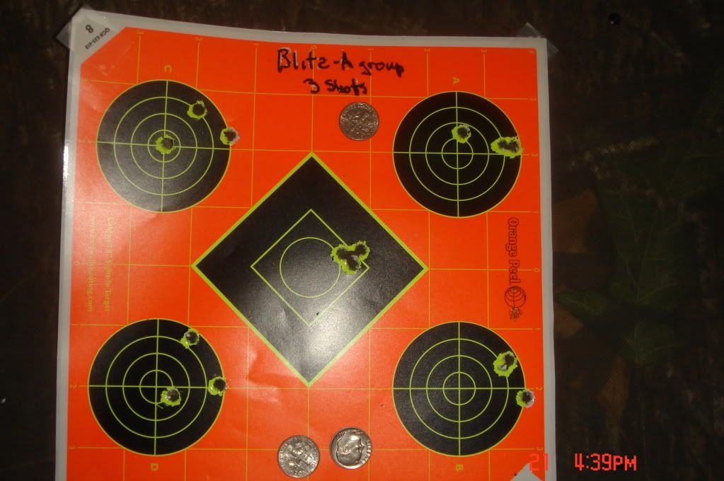

here is a pic of the best group i shot all day (middle group)

Well I think your neck tension is pretty tight to leave that kind of mark no matter what seater die you are using.
I think a factory 22-250 is capable of shooting half MOA at 100 all day long if you do your part and load well. If my factory Weatherby Vanguard is not shooting half MOA, I am not doing my part. I would suggest a little more power on your scope. Hard to shoot small groups if you can't tell one shot from the next under your cross dot. As far as the Axis goes, got one for my son in a .243 and he shoots in the 5's most of the time with my reloads, 24 power scope, a solid bench and rest. From what I have read, you have a 50/50 chance of getting a Savage that will shoot well but since you have shot in the 3's already, I would think with the proper load, it should shoot well enough for what you are trying to do.

Groups hovering around 1/2 moa is outstanding for a factory rifle. Of course we all want tighter but you could spent a lot of money and time trying to achieve it. Depending on your purpose, 1/2 moa will get the job done for hunting.

IMO for that cartridge, worrying about .1-.2g is a waste of time, spend time with jump distance YOUR barrel and bullet like first, then refine the powder charge for desired speed and the nearest accuracy node.
Pretty much every 22-250 20"-28" barreled rifle ever made likes around 38g of H380 and pretty much any 50-55g slug (along with ~34g of 4895). Load up iterations of jump distance every 10 thou from just touching to about .050" off. Which one does it like? there will be one or two in that group of 6 distances that stand out. A LOT. Want more speed? Then load more powder. They tend to have accuracy nodes about 1g apart.
I'm going to bet about .030"-.040" (and any multiple of that as that throat gets chased down the bore) works pretty good.
I would also like to discourage a new 22-250 shooter from being a Speed Demon, you just waste cases and barrels, its sort of cool, but a waste in the long run. Yes you can get 50's close to 4000 FPS easy, but they shoot better and longer slowed down.
When you find the right jump distance for the slug and barrel your groups will close DRAMATICALLY regardless of what known, works good in a 22-250 powder is in it.

DON'T shoot 3 or five of the exact same load consecutively, shoot one of each type at its own target one at a time, spread the statistical errors and shooter errors over ALL the groups. 3 shots is not enough to get a decent statistical sample, 5 is better, ten is better yet.
More than a few times that ten shots in a dime group DID NOT START AS THREE TOUCHING! It started as three in a small triangle, and the triangle got filled in. That particular load stayed pretty consistent over time, heat, change of positions. Then there was the two in the same hole with one off 1/4" group that you think you pulled the flyer, but when you shoot the other seven it opens up even more.
