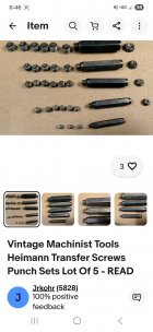

What you are looking for is a transfer screw.
Heimann is the most common name of them.
I have several different sizes and they sure do come in handy when you are trying to mark a hole.
The handle has a hex wrench on the end to screw them into the hole and they also store in it.
Joe
