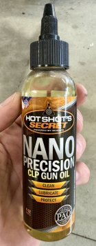

I use CRC Mass Air Flow Sensor solvent for initial cleaning and HotShots Secret Nano Precision CLP gun oil for lubrication and keeping it clean during operation. The HotShots oil is good for operating down to -50F and it also cleans really well as it lubricates parts. Literally melts away carbon, much like the detergents in motor oil do for an engine, but it’s much thinner so it’s works fine with the intricate parts of a Jewell trigger
