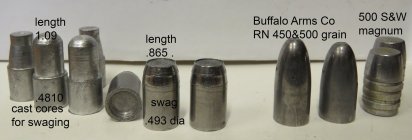

Thanks FeMan, you answer my question and not knowing provided link-showing calculator I was using. Input was random numbers trying to understand output data. I have 450 RN and 500 RN-grain bullet (.492 dia) from Buffalo Arms for paper patching. 1.0560 length 450-grain RN and 1.1415 length for 500-grain RN, muzzle velocity guessing around 1350.0 ft/s . GM barrel 1:28. I did not see input for altitude but its 1,650 ft when calculated output data stability shows 2.211 and 2.062 for those two bullets. Also have a cast lube bullet 500 S&W Magnum (.501dia) .8985 length 440-grain FN, output data stability 3.485. I was hoping this bullet would work for me but at 50 yards wide spread and some keyhole on target. The two round nose paper patch bullets from buffalo Arms group around 3 inch at 50 yards using iron sights. Thinking had I sighted in at 6 o'clock on 3 inch bulls would have done better as front sight completely cover 3 inch bulls at 50 yards. When doing some more reading saw my paper patch was wrap to long past the ogive on bullets. Shorten wrap but have not shot them yet will be looking for improvement. I want to build my own swaging dies; modified an old pistol die trying to copy that 500 S&W Magnum for paper patching. It was far from perfect lol but learn a lot in doing so, thinking the need to copy those round nose from Buffalo Arms as they are not cheap. Will post pictures of my first attempt at swaging if I can figure how too, thanks. Free Trapper
