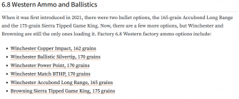

This is a list of the bullets currently available and used in the 6.8 Western:
https://www.outdoorlife.com/guns/6-8-western-cartridge-review/
There are a couple of corporate ballistic table there as well.
There care a couple of corporate ballistic table there as well.

That's only factory ammo.
Hopefully 270WinDude reloads!
If so there are many more bullet choices!
