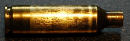

My issue is this: When preparing these same fireformed cases for reloading I first decapped them, re-uniformed the primer pocket, cleaned them then tried to resize them. The sizing die had just been cleaned with GunScrub and a brush then relubricated with Kroil and the case neck and shoulder lubricated with Imperial sizing wax. The case went into the die up to the point where there was about .5" protruding from the bottom at which point there was extreme resistance. By applying a *lot* of pressure on the press handle I was able to get the case all the way into the die and then back out again. I checked the die to make sure there was no dirt, media, etc stuck in it then tried another case with the same result. After removing the bushing and the threaded insert that holds the bushing in place,as well as contains the expander plut & decapping pin) I tried a 3rd case and this one nearly got stuck in the die at which point I quit. As you can see, in this 3rd attempt I had removed all components except the die body itself so I know the issue is not with the bushing or the threaded insert.

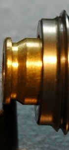

I have a piece of unfired Tubb 6XC brass that came with the 6XC tooling for my Giraud case trimmer and that case protrudes about .25" from the bottom of the die before meeting resistance,which is, I assume, normal). As I mentioned before the brass fired in my rifle protrudes about half and inch from the bottom of the die before meeting resistance and continues to do so even after being resized.

If you've lubed the case body effectively and you STILL can't move the case in/out of the die without great difficulty, then yes I'd say you've got a mismatch between the die and the chamber. From the photo it also looks like the die is working the case body pretty heavily.

But bottom line, if the case sticks with an application of Imperial on body and neck, there is an issue. The banding visible in the third picture above also suggest some issues with the reamer or the chambering job.

Do you mean the alternating light and dark stripes up near the shoulder? Can you expand on what sort of issues there might be?

When you see bands like that on a fired, sized case, assuming the die is properly finished, it means there are high/low points in the chamber. This can be caused by a reamer whose cutting blades aren't finished right, or by a reamer that chattered, or it can be caused by various smithing issues such as not flushing out the chips during finish reaming. A good smith can explain this in greater detail. Often the solution is just a little gentle polishing of the chamber with some Flitz on a patch on a tight-fitting dowel. But with a really "ace" chambering job, you won't see that kind of banding on a sized case.
IMHO, by the looks of the 3rd picture it is most definitely a chambering issue. My 6XC chamber was cut with a Hendrickson,sic)? reamer and my W-W cases re-size with no more effort than my 223 cases do using Imperial sizing die wax, Redding dies and Redding T7 turret press. I would be on the phone to McBros. if it were me.
