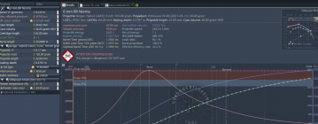

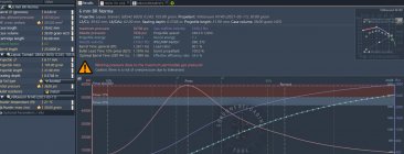

I am running 30gr of N140 in 6BR shooting 105gr Barts Infinity bullets. I chose Berger Hybrids in GRT because it's ballistically very close. It seems that my load is unsafe. Surprisingly, if I was loading 105gr Scenars, the load becomes safer acccording to GRC. Is anyone running 30gr or more of N140 behind a 105gr bullet?grc nonesense.png
GRC has max pressure at 58,740 PSI for this cartridge.
The Berger is at 58,760 PSI 20 PSI over max pressure.
The Lapua is at 58,708 PSI 32 PSI under max pressure.
Difference between the two bullets is 52 PSI, very small but GRC is not without
error.

I suspect you're at the point where predictions are useless. Go with what your rifle tells you (unless this is all theoretical, in which case work up slowly towards it.)
It’s a trick question.
Either both are safe, or both are not.
If 50psi difference means the difference between pieces parts in your face or not, junk the rifle it’s not safe to shoot that cartridge. Rebarrel it to a rimfire.
That said that same pressure swing on even the best loads will happen on cold and hot days, even the same day if the temp swings or not. Maybe even raking 30 seconds difference between shots with a hot barrel. The problem with the comparison is that it’s immeasurable. The 50 psi will be within the margin of error, and no one shoots a match with pressure test barrel. Then the .2 fps velocity spread is what shooters dreams, more likely night mares, are made of. No way to measure that.

Like any other computer simulation, its only as good as the data you feed it. Everything must be measured to get accurate data. After this, calibrate the powder model by using the OBT tool to match measured velocity. I have a number of calibrated powder models saved. Powders burn differently in different rifles and cartridges. Once calibrated, GRT is quite accurate.

This is the answer. GRT is SWAG until you plug in real data and curve fit by using OBT. My load for my 6br using 105 and Varget is 29 gn.

You left out the "according to GRT" part. That is a screen-based judgement, not a physical shooting thing, and will allow you to grade "safe" based on small changes that would likely not apply to real-world scenarios. I understand what you're saying, but you are talking physical, and the discussion was pretty much theoretical.
GRT likes a buffer of 15% under the published max pressure; anything above that (despite being "acceptable" per the published standards) is considered "risky" or "dangerous". So those definitions are GRT-based as well.
In any case, the transition from theoretical, simulated results to real-world physical results is generally iffy, which is why I said the area he's working is better tested by actual results rather than by GRT.
