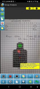

My Green Mountain, SS, 20 inch Barrel on my 10-22 will shoot, in the 3's and 4's,.. repeatedly
( 5 shots @ 50 yds ) with, SK Standard Plus and Wolf, Match extra,. BUT the 2.25 Pound Trigger, holds the Rifle "Back",.. IMO ( It's set up as,.. a Hunting Rifle ).
