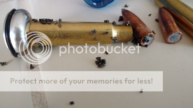

Popped a couple of .223 rounds out back to check forming. Went out the next morning and found a live round laying in the grass that I had dropped. It was WET!!
Pulled it down and the had powder clumped. Had pretty good neck tension.
Figure if I'am out in the weather, might be best to seal them, just in case.
