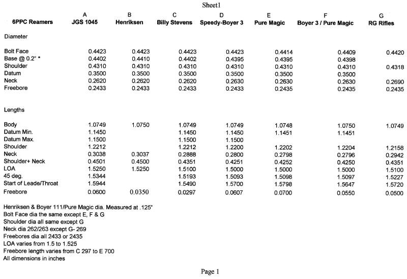

I started doing my own barrels almost 10 years ago. Started out with a ppc that was .440 at the 200 line and had .060 freebore length with .2433 freebore diameter which was nearly as the gold standard 1045 reamer
I fought that thing for two years. After speaking with other competitors and on this forum after two other versions I have gotten to a reamer with no clickers that works well with my bullets
It is an interesting process to work thru and is satisfying to get there. For the PPC there is no Robinette V2 so you do have to figure it out yourself.
Study the Robinette v2 as Al advised and learn what makes it work
One example of working with a proven reamer and tweaking it for a particular useage. The yellow highlighted are my changes.
