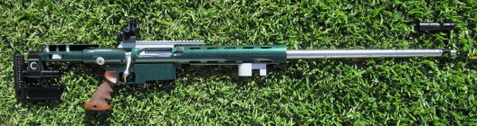

My RTM is shot in both Palma and High Power. I have both lowers and .308 and .284 Win barrels. The attached image is wearing the .308 barrel. Mine is a Pierce long action repeater and may also be seen on Gary's site.
