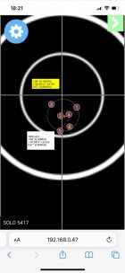

You, as a certified scientist and doctorate, should know this target doesn’t mean sh*t without some frame of reference. What bullet? Mv? Distance shot at? Conditions?
This target is laughable if shot at 100 or 200 yards, I would not be please with this target at those distances at all. But reference and a legend are key here. You wouldn’t include a picture or graph in your doctoral thesis without references, notes, legend, and true measured data. No offense intended (which clearly means I’m about to offend you) but, you are definitely losing credibility with this thread and how you are approaching the audience here. Perhaps we can rewind the clock and start over with a different approach.
