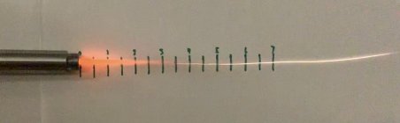

It is surprising how much energy primers have. This is a test I conducted on a Federal 205M. The barrel length was 22”. Nothing but the primer in an empty case. Be careful everyone.
