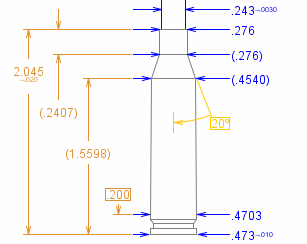

According to my quick calculation, you cannot ream to a standard 6mm Rem. The .243 is a very straight case, while the 6mm has quite a bit of taper. That is probably why the 6mm really has no significant extra capacity. However if the 6mm AI is very straight like the .243 then it may work.

.243 Winchester
.244 (6mm) Ackley Improved
