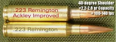

Oh how I wish I still had a Lab and microscope. The location is not exactly below the annealing interface, however it is very close and may in fact be in a transition zone which combined with your question about how much sizing leads to a whole new though process.
Let's also keep in mind, if this was fire formed into AI from normal 556, then this location is very near the original shoulder radius.
Even with good annealing, you can still find evidence of grain structure from that original radius where the cold work of fire forming forced it straight. In the SEM, we will often see micro fractures there that just take a long time to propagate.
That was a hard bend being straightened out. Other times, with this many cycles, you will see the failure at the bottom of the neck where we forced that new bend.
Brass is magic, but it still has limits. Twenty three cycles is what I would call a success. YMMV

That is a good observation. Annealing doesn't take the brass back to a vrigin state, i.e. "Soft", but probably more to 1/4 hard. The only way to take it all the way back would likely make the whole case so soft it would be useless and possibly unsafe in the case head area.
Yep. We can in fact soften the neck too much if we are not careful. The target values for hardness in the neck is roughly 90 to 115, but if you over do it you can get down below 90.

Yes it was more difficult to accurately measure the datum line on the AI case with a standard gauge. I had a custom gauge made from the same reamer as the chamber and I find it to deliver much more repeatable results. And yes there is also less trimming than I used to experience with a straight 223.

It looks to me (my opinion only) that the separation is where the shoulder would blow forward and straighten the case. Maybe thin brass to start with. But after 23 loadings maybe it just got worn out!
