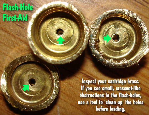

Lapua flash holes are not drilled. There is a punch that comes from the top and meets another metal unit that comes from the bottom. I check flash-holes for a little "quarter-moon" sliver of brass that sometimes appears. Otherwise I don't touch the flash holes.
I maybe see something like this in a few cases per hundred. My last box of Lapua 6BR brass had no issues. Do you need to mess with your flash-holes? We have seen no accuracy advantage to flash hole reaming, and one problem is that many of the tools have oversize bits. Read:
http://bulletin.accurateshooter.com/2012/12/flash-hole-first-aid-removing-flash-hole-obstructions/

All things made by men will fail, even those of brick and mortar. I was in manufacturing a long time and nothing is perfect. I prep 200-500 Lapua cases per lot, several times per year. I've seen a variety of manufacturing problems and brought them to Lapua's attention. What sets Lapua apart from most other manufacturers is the low incidence of significant flaws, not the absence. They do occasionally have flakes at the flash hole that should be removed before firing. [br]

Amen , here ! Nothing is perfect ! Here's some of the problems I've encountered with Lapua cases lately , and I have also brought these issues to their attention . Flash holes that are only partial or have eratic configuration . Rims that are thicker on one side than the other or just plain thicker than the rest of the lot . Split necks or slits in shoulders . Nothing is perfect !!!

The problem is that most of the reamer tools on the market are NOT sold with bit sizes you can have confidence in. The Lapua Flash hole spec is 1.5mm which = 0.059. I've seen a Possum Hollow unit that cut to 0.067, a K&M that cut to 0.068 etc. When I reamed 6BR flash-holes with that 0.068 K&M tool, pressure went up slightly, and my ES rose. YMMV.
Additionally, with the tools that come from the inside and cut a counter-sink hole on the inside it is very easy to over cut the brass, or remove brass inconsistently from case to case.
Apart from knocking out obstructions (easily done with a constant diameter bit in a pin vise), I'm convinced some that people are NOT doing themselves any favors by messing around with flash holes with tools that are generally NOT the 0.0625 as claimed.
