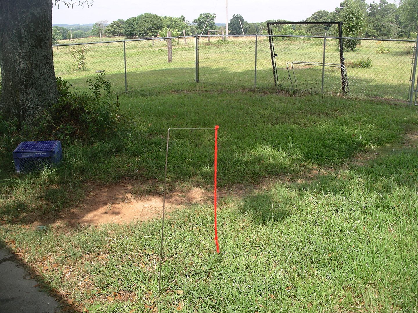

this simple wind flag works well, we drove off and left a lot of them in SD, and they are very simple and easy to make:
1/4" stainless or chrome moly rod, 42" length works best, 36" in the very least. Drill a hole in one end, sharpen the other end.

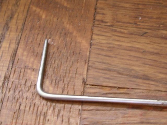

sharpen and bend the end of a bicycle spoke or thin brass rod:
Now bend the other end of the bicycle spoke to hold a 1/2" piece of red yarn:
now tie the knot on the yarn and you are done:
