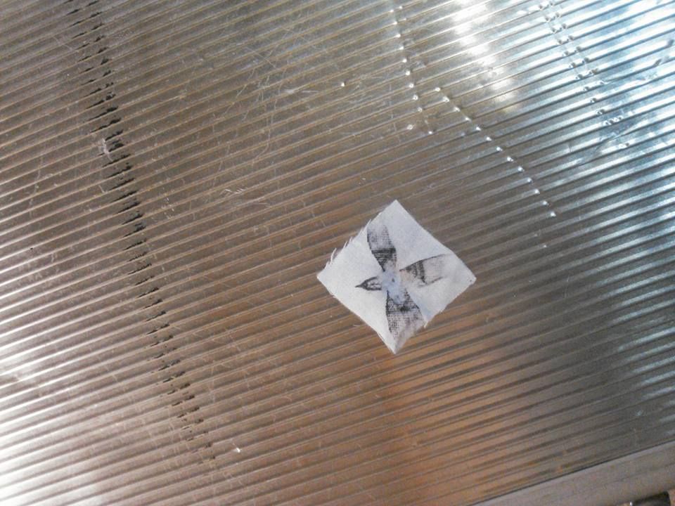

My gun has been cleaned twice after the match the way I generally clean it, this was a third time starting with IOSSO.
First dry patch after 8-10 passes with IOSSO
Ray
