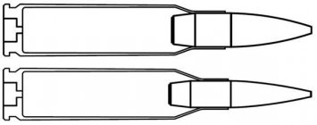

The trend to smaller calibers in magazine fed rifles is happening for a very good reason. For a .308 Winchester round, you only have 2.37 calibers of nose length available for the bullet to protrude from the case. Such a short nose will have relatively high drag for the caliber. By contrast, smaller calibers such as 6.5mm and 6mm have proportionally more length available for the nose to protrude from the case and still fit in the same COAL constraint. 65 130 AR Hybrid Cartridge ComparisonProportionally longer noses mean lower drag. Proportionally longer bullets mean higher sectional density. Combine an elevated sectional density with lower drag, and you get higher BC bullets. For example, consider a 175 grain .30 caliber bullet commonly used in .308 Winchester; M118LR type ammo. These 175 grain bullets have G7 BC’s in the neighborhood of .243 to .260. Neck the .308 down to 6.5mm (260 Remington) or 6mm (.243 Winchester) and now look at the BC’s of the bullets available in these calibers which work within the same magazine length constraint. The 6.5mm 130 grain AR Hybrid has a G7 BC of 0.290, and the 6mm 105 grain Hybrid has a G7 BC of 0.278; both of which are higher than the .30 cal 175 grain bullet. Furthermore, you get hundreds of feet per second more velocity with the necked down cartridges as well.

I understand the rationale for this bullet for those shooting rifles that have magazines with limited space but I guess the question is for those shooting AI-based rifles with magazines that can accommodate rounds of extended length, is there specific advantage of using this bullet over the Berger 140 hybrid.
jlow,
I guess it would depend on if the seating depth for the 140 would exceed the AI magazine dimension. Having never had the pleasure to actually shoot or study this rifle I don't know if that is even possible or not. Just throwing it out there. A "back up" to the 140 or 130 VLD. I am sure there may be more.
Can you load the 140 to AI mag length and have the boat tail above the neck shoulder junction or is the bullet down in the case? The 130 may increase your powder capacity.
Thanks Phil! The AI mags are very generous and have internal length of about 2.98”, so with your 140 Hybrids, touch length in my AI AT is only 2.92” and I find a jump of 25 thousands works best for me so OAL is not an issue. G7 BC is 0.317 vs. 0.290 so not exactly a contender. The only reason I can think of is if donuts gets to be a problem for me but so far so good in that department for me - I'll keep my fingers crossed.
jlow,
I think in a 6.5CM or 6.5x47L, the 140's work great, and fitting in a mag is not an issue. I run a TRG-22 in 260, and the 140's were either too long for my mag (max mag is 2.95") or seated too deep in the case. The 130's are a perfect fit! I have done some preliminary load testing with H4350 and got them up to 3000 fps with no pressure signs. If I can SAFELY maintain these velocities, I think the ballistics will be pretty close (maybe better?) than the 140.
I also have some highly Top Secret powder on the way which may add another 150 fps, with a lower pressure. Results to be determined!

Hi FTRinPA – when you say they were too long for your mag, how long were you seating them?
Kind of hard to imagine at 3000 fps your BC would be better than the 140 Hybrid (say compared to mine at 2,850 fps). I mean looking at the table listed in the OP for the 130, the increase in BC from 3000-2500 fps to above 3000 is only 1 in G7 BC and the difference in average G7 for the two is 0.317 vs. 0.290, that is 27...?
The 130s are shorter to fit in the mag and that in turn cause the significant decrease in G7 BC, I don't see anyway around that?
