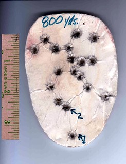

Here's what my .308 Win. Palma rifle did in a test of Sierra's then new 155-gr. Palma bullets at 800 yards.
Paramount action with a 3.5 pound trigger, Kreiger 32", 1:13 twist .2950" bore & .3075" 4-groove, SAAMI chamber, unprepped WCC60 cases full length sized, 45.3 gr. IMR4895, bullet runout .003", soft-seated bullets set back about .010" in case when chambered. Rifle scoped for accuracy test with a Weaver T20. Tested at 6 AM when the wind was calm.
Two sighters used to get a zero then clean the barrel before shooting 20 rounds for the test. Numbers 1 and 2 were the first ones shot and the rest went a bit higher; that barrel shot bullets a bit faster after a few rounds of barrel fouling. Shots fired about every 25 to 30 seconds slung up in prone with a rice bag under my front hand and another under the toe of the stock.
2015 fps ?????
