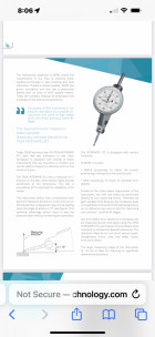

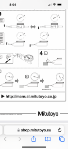

Not looking to dis what you are doing, but that is not a valid test. Each stylus is at a different angle. DTI need set at a certain angle to minimize cosine error. Cosine error is real and not many realize it. Measuring with a DTI to resolve a dimension is tricky. 99.9% of the time they get used to indicate to obtain a zero condition(not measuring with it). The indicators that are showing more run out is most likely cosine error.
I think I read somewhere on the mitutoyo web site that its reads best at 12 degrees? I think
Something like that. If measuring with it, I'd check it with a known standard to make sure it resolves correctly. We don't really measure with a DTI.
Do the numbers on a mitutoyo 513-401-10E fitted with a long indicator. They are 1 micron with a 11.2mm contact point and have a large face.
Mitutoyo 0°/90°
Interapid 12°/78°
We really aren’t measuring anything to a specific dimension in this application so the angle wouldn’t be critical.
