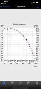

Sounds like that’s walking the fine line of pressure. Perhaps back off a little and see what real world difference it makes. I have been in your situation and pushing things further than I should but when I ran a few number in a ballistic calculator, I realised it was all for naught. That’s just my opinion.
The below image illustrates what I mean. At 600 yards there’s 12in more drop with the 3450fps loads, a distance that is always going to be dialled. Until 400, the two are almost identical. Moreover, in a 7mph full value wind, the 3450fps rounds drift 6in compared to 5.1in with the 3600fps. Is that difference worth it? If so, go for it! But for me, it’s not.
