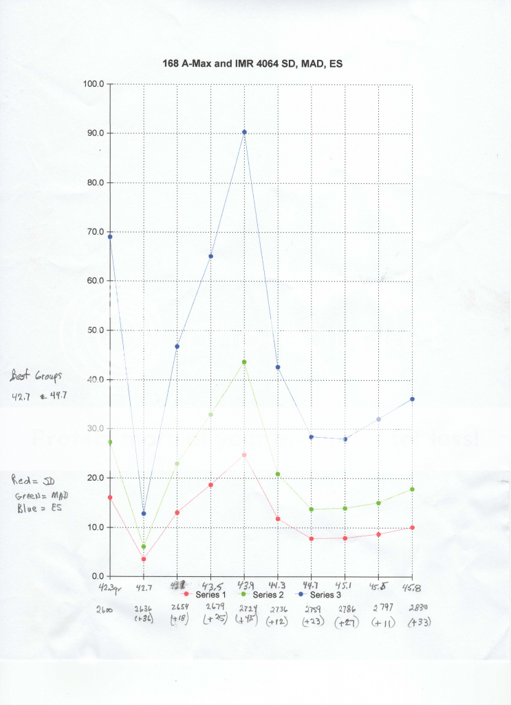

Friday I put it to the test. Loaded a series of rounds in .4 gr increments using IMR-4064 and 168 gr Hornady A-max bullets. Shot the series at 200 yards so I could could sort out a really good group easier.
Cases were all previously shot and even in all aspects of prep. Primers were BR-2.
Starting load was 42.3 gr and last load was .1 gr less than published max. All bullets were seated just to the lands. The starting load was enough to keep soot from covering the outside of the neck and not a single pressure sign at the ending load.
Here's the chart I generated from this series shot over the chronograph.
Found it very interesting that the best groups were at 42,7 gr, 2636.2 fps avg (a "bughole") and 44.7 gr, 2759.9 fps avg. (<1/2"). These groups coincided with the dips in SD, MAD, and ES.
Maybe the chrono stats DO mean something ;) ;)

That's actually my next step. Today I'm heading to the range to test the two "accuracy nodes" that appeared on the first "sweep" and if they repeat (not science if they don't), I'll start testing the seating depths, recording every shot on the chrono. This is when it's nice to have a printer incorporated into the Chronograph.
Looks potentially interesting but, I don't understand what the Y-axis represents.
Joe
jcinsa said:
Hey Amlevin,
On your graph, what does MAD stand for ?
Can't guess what it could be.
Thanks
John
Mean Absolute Deviation or as some might also say Mean Average Deviation.
Essentially the the average of each shot's deviation from the overall average.
In some ways this can be more meaningful than both ES or SD. If you have a MAD of 5 fps and at the range at, one fps of speed variation means one inch of elevation, then statistically each shot will hit from 2.5" above to 2.5" below the target center, all other things being equal.

From your chart I would expect the 42.7 grain load to be temperature sensitive and the one at 44.7 to be much less so. Have you noticed anything like that?
Not sure I could draw that conclusion myself unless you feel that the chamber temp was affecting the higher weight charges which were shot later in the sequence. FWIW, I don't sit with a round chambered any longer than necessary to acquire target and pull trigger. If there's a delay, like waiting for wind, etc, I'll unchamber the round and let it sit on the magazine follower, closing the bolt when all is ready.
