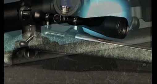

Here is a nice video that probably explains why you can’t purchase an action by it’s self.
One of the interesting items is they achieve the final head spacing by machining the bolt face.
One of the interesting items is they do the final head spacing by machining the bolt face.
I know they said that. (I cringed there and the grinding wheel spark shower - I own these guns.) The video seemed to show it, as well. But to my primitive mind, that’s the single worst idea I can fathom, and I hope it was just an enthusiastic video talker who got carried away on the general theme of hand massaged guns, but I doubt it. (It was said when discussing the aesthetic timing of flutes, and if they start shaving the shoulder, and then the bolt face by the same amount, all because they want the flute to stop straight up, then I’m philosophically opposed).
If the bolt head depths are all different, is the firing pin protrusion different on all these bolts? So there’s no standard firing pin replacement? None of the bolts are actually interchangeable gun to gun? There’s no reliable Weatherby spec tenon dimension? It’s just “whatever” plus or minus up to a 6th of a rotation?
I didn’t go to gunsmith school, but isn’t it taught that you alter the consumable barrel, not the action and bolt?
While I usually like candor, I have to say, seeing Nightforce test scopes, seeing new Ferraris driven over alternating speed bumps in Maranello, fast, seeing doctors test ACL ligaments, everything I have ever done to a rental car, … these are not our good sides to the camera, as they say.
Fair points.
A few thousandths difference either way with FP protrusion isn't any sort of issue with a hunting rifle, and even with less rigorous tolerances of production machining ops it shouldn't vary more than that.
