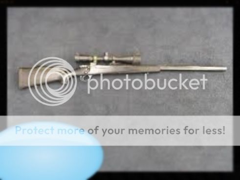

I came across a Interarms bolt action rifle that is for sale.... but know nothing about them, and was wondering if anyone has any thoughts about it.
I'm not sure what model it is, but someone has tried to turn it into a long range shooter because it has a long, heavy duty, 25-06 bull barrel on it... I mean heavy.
It comes with a centerpoint scope as well.
The whole package is 350.00 plus taxes... is it worth it...?

Interarms used to import commercial Mauser 98 in a variety of calibers from Yugoslavia (a little hazy here) but the importation of them was embargoed during the Bosnian/Serbian war. After peace was had Charles Daly imported 98's from the same factory as did Remington in the 798.

It is a commercial Mauser 98 action. The action alone in good shape will bring $300+ all day long. It's a good deal. It will have an adjustable trigger as well. Won't get you to ounces but under 2# is realistic. Most can benefit from trueing but I would guess that it will shoot fine. The Yugo barrels are actually pretty accurate for hunting rifles as a rule. They were hammer forged and clean fairly easily.

found a picture of it....

Depending on age it may or may not have a adjustable trigger. Some of the early ones had non-adjustable triggers with military style notched cocking pieces.
They are nice rifles and robust as far as strength but throw the scope on ebay and get a good one as centerpoints are worse than tasco's.
They do not make a good long range rifle. I think you are getting the receiver only. If you can sell enough stuff, you may come out I thought they were made by CZ.

Interarms sold complete rifles, barreled actions and actions only, over a long period of time. So you can run into all factory rifles, barreled actions with aftermarket stocks and actions that have custom barrels and stocks on them. All manufactured by Zastava in Yugoslavia as I recall. Actions were strong modern steel, but not machined as smoothly (inside the receiver and inside the bolt body) as FNs were. The factory barrels were surprisingly accurate for the most part.
well... I took a better look at it, and found out that it is setup for bench shooting with the super heavy bull barrel and single shot feed. The barrel I can live with, but wasn't sure if I wanted to live with the single shot feed... since I'm more of a hunter instead of a paper hanger. I'm probably silly for not taking it home with me yesterday... but I've got a few more days to think about it.

I took another look at this rifle today, and couldn't pass it up at 300.00 plus tax from a Pawn Shop... so now I have this Beast or Beauty, and not sure which to call her at this moment... time will tell. Now I need to buy dies and bullets in order to fire up her engines. I'm not sure what to buy right now, since I've never owned a 25/06... any helpful ideas will be appreciated.
The barrel is as big as a trailer axle, 1-1/2" wide by 26" long, which makes you think that someone tried to build her into something special, but I'm just guessing.
My only desire for it is to shoot long range coyotes... but it probably won't beat out my 22-243 AI with 90 gr Bergers... don't even know what's best for her... but I'll have to find out soon because I plan on going out West for Nov-Dec to chase those coyotes, with hopefully getting some long range shots.
